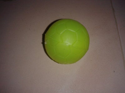

1) Small Ball.(hard enough to with stand in the hot glue temperature)

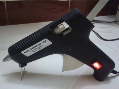

4) Hot Hlue gun.

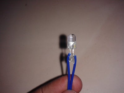

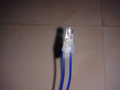

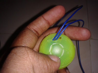

1) Connect two wires to the LED and cover the lead portion with glue gun.

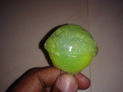

2) Take the ball and cut the bottom side of the ball to the size of the led.
3) Insert the Led inside the ball and cover the cut region with the glue gun.
4) After glue dry. Take a bucket of water and immerse the ball inside the water, to check any leak in the ball.

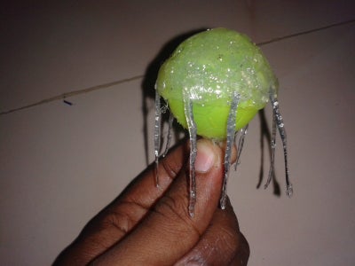

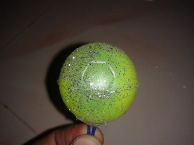

Step 3: Finish the Body
1) Spray glitters over the top of the ball.
2) Cover the top portion of the ball with hot glue gun. (As per eraly told ball must be hard enough to with stand in the glue gun temperature, Because at first i lot 2 balls).
3) Allow it to dry.

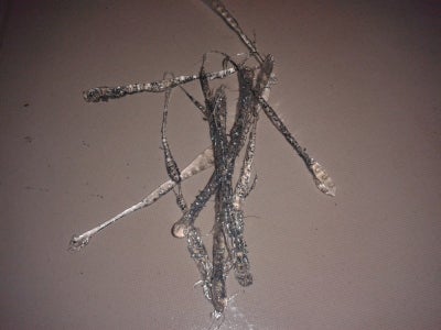

Step 4: Prepare Legs With Suckers.

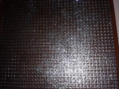

1) Take a big plain PCB board.
2) Apply oil over the PCB board.
3) Spray Glitter powder over the pcb board.

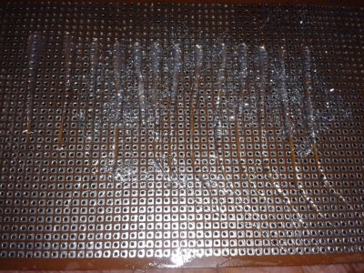

4) Use glue gun to make legs.
5) Press the trigger in one place and move down while reduce the pressing speed.
6) Make eight legs like that.
7) Allow it to dry and remove the legs. The legs some with suckers(PCB hole).
Step 5: Join the Leg With the Body
1) Hot glue the eight legs with the body we already made.

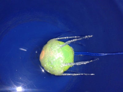

Step 6: Finishing and Let It Float
1) Leave some wire below the ball and tie a weight (I use a pipe available near my hand. If u have stones then its fine.)

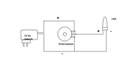

2) Connect the circuit as per the diagram.
3) Now put the octopus in the fish tank and switch on the power supply.
4) I show it in the bucket because my house has no fish tank. (It glitter and Glow in different colors)
