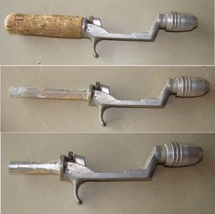

Step 3: Get the Handle Ready
The cork was removed from the grip area of the fishing rod handle, and the exposed shank was shortened to just over two inches. There was a small ridge on each side of the handle that was used to keep the cork from spinning. These were filed off so that shank would fit snugly into the hole that I would be drilling into the grip of the wood cane.
A 3/8 inch bolt has the same diameter as the original fiberglass part of the fishing pole. (Different handles use different sizes.) The head of the bolt was cut off. The remainder of the bolt will be glued into the bottom part of the wood cane, and this is how it will be attached to the old handle.
