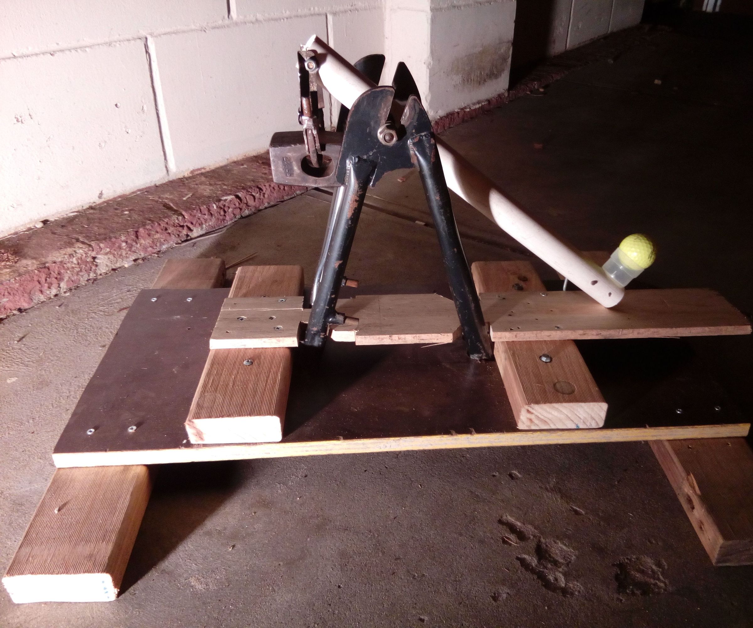

Step 1: OutRigger Mount
Materials:
PVC tube 42mm o/d x 1000mm
Roofing Batten 2x (channel 25x45x45x25mm) x 200mm
8mm tech screws
Step 2: Outrigger Pontoons

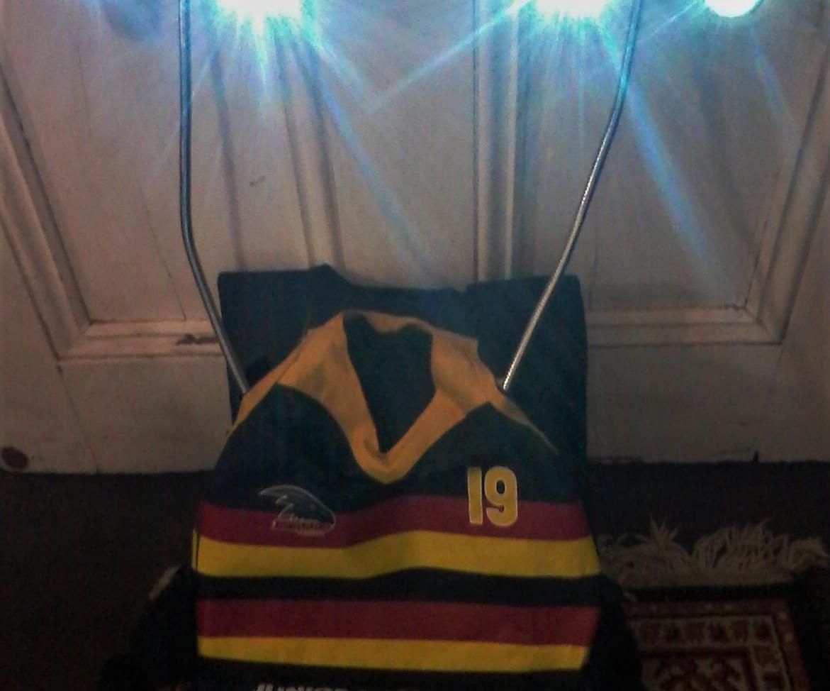

Step 3: Dual Purpose Headlights/Underwater Lights
Materials:
PVC pipe x405mm
PVC pipe
LED Lights
Electrical Wire
Silicon
Araldite two part epoxy glue
