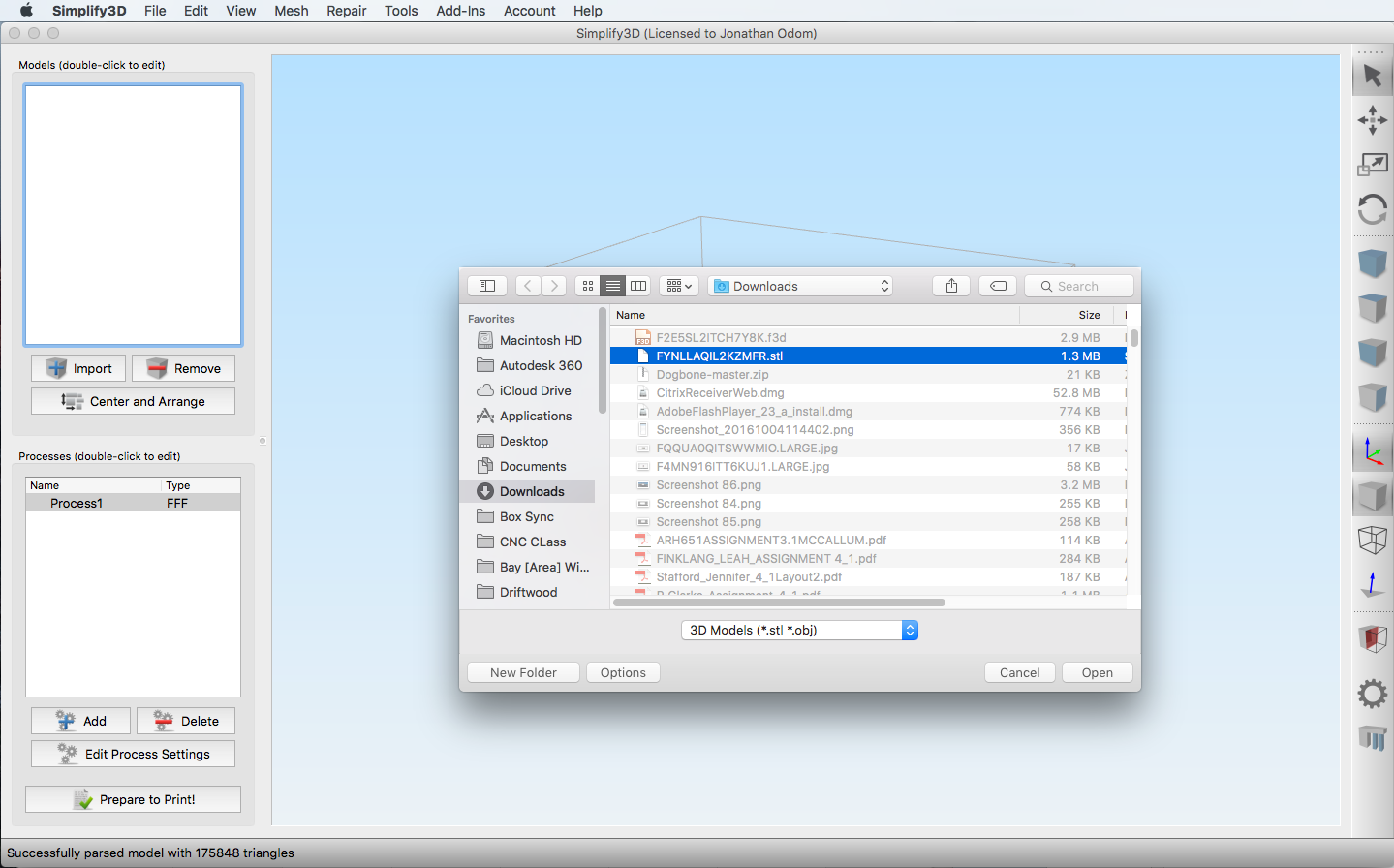

1.IMPORT: In Simplify 3D, click the Import button on the left-side panel, and select the Fit Tests STL file in the browser.

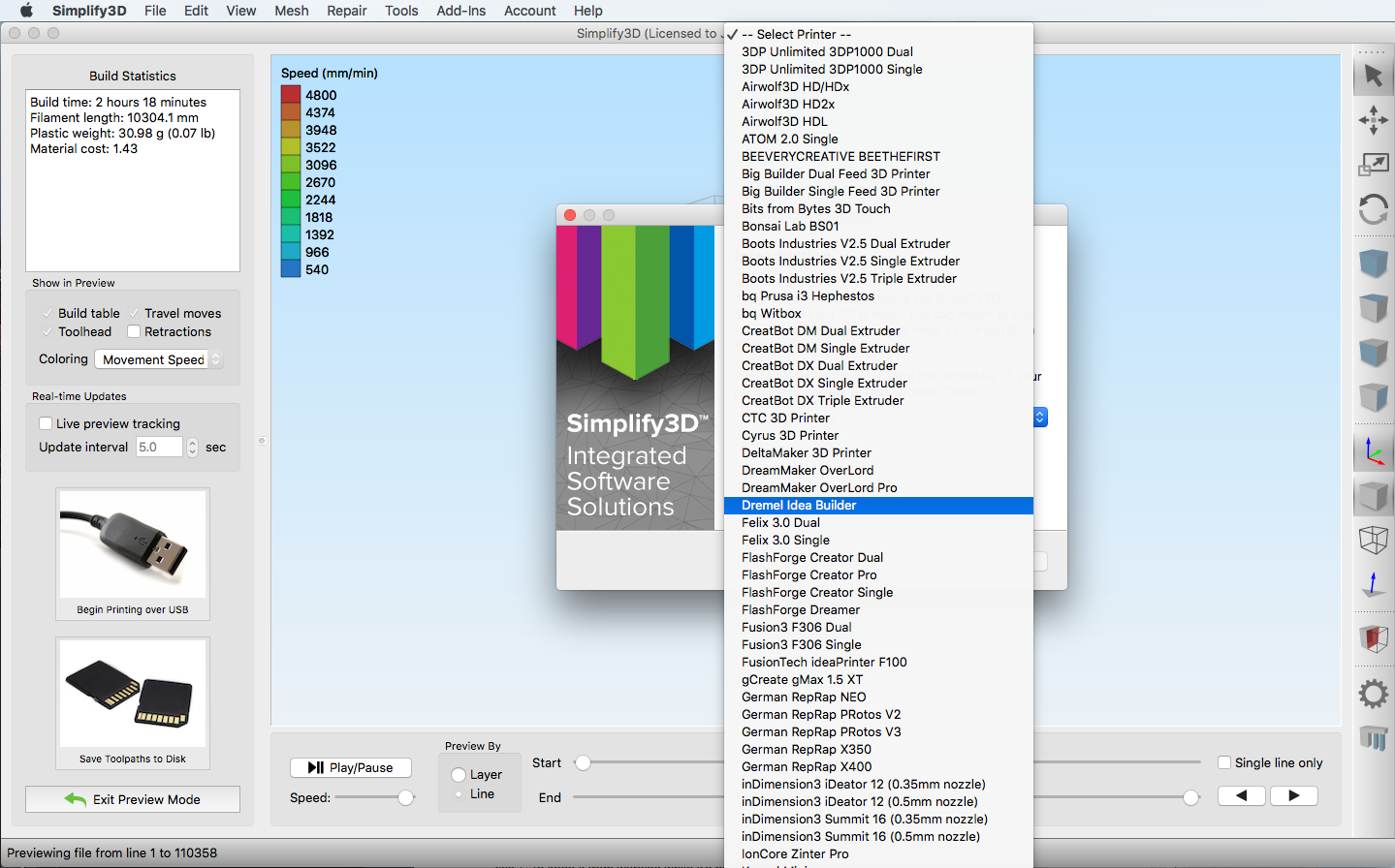

4. CONFIGURATION ASSISTANT: On Mac, this option can be found under Help > Configuration Assistant. This is a setup wizard that will apply the necessary settings to the program, giving you useful default settings for printing. It will also export the tool paths (instructions the 3D printer can understand) in whatever format your 3D printer can read.

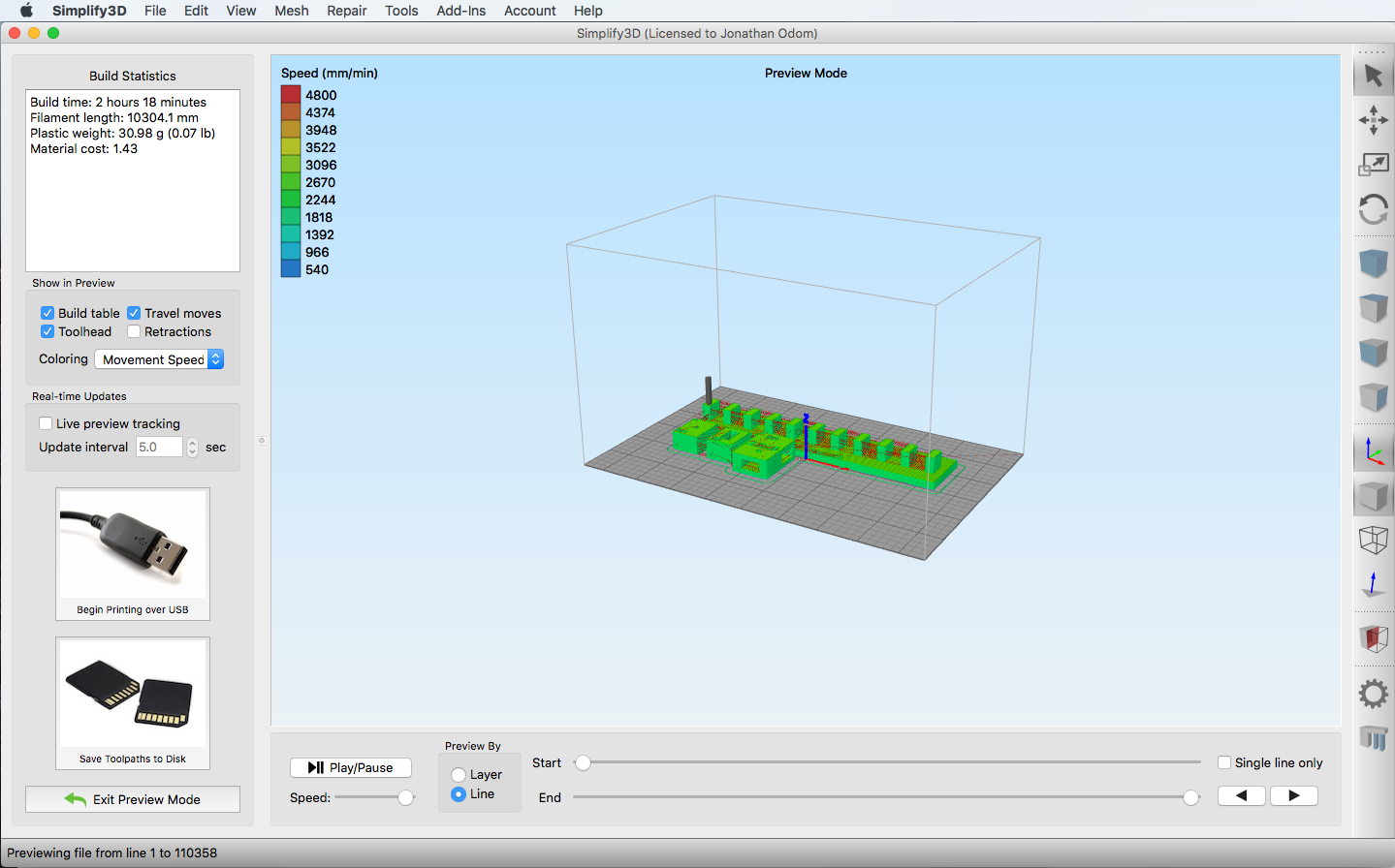

5. EDIT PROCESS SETTINGS: Click the Edit Process Settings button in the panel on the left to open the settings panel. The default settings are a good place to start, but as you're troubleshooting, this is where you'll be making the adjustments to get better results.
6. PREPARE TO PRINT: Click Prepare to Print, and Simplify 3D gives you a tool-path with supports using its default settings. You can move the Preview sliders to see how the print head is going to build the model. Click Save Toolpaths to Disk, save the .g3drem file to an SD card and that’s it! You're ready to start printing.
