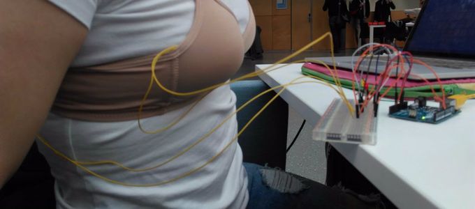

Step 5: Step 5: Testing in a Bra
After testing our circuit , we wanted to see if it would work. We made sure that the sensors were connected to longer wires to make it possible to put the sensors inside the bra.
By putting the bra with the sensors on the mannequin, and making one strap shorter ( putting more pressure on it) we could see the lights turning on.
