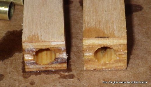

USE 1 - GLUING PENS:
I ALWAYS put down a section of cardboard onto my workbench when using CA (cyanoacrylate adhesives) glue or epoxy. Most of the time I use CA glue is when I'm going to make a pen. The process of making includes gluing a brass sleeve into the pen blank, CA glue holds this tube in place. CA glue is a quick drying glue (sometimes referred to as super glue). A small amount of glue often runs down the face of the pen blank and if I were to put that directly down on on my workbench those two will become one when the glue dries! To prevent this I place a piece of cardboard under my gluing efforts. If the pen blank has a bit of glue on it and it adheres to the cardboard I just rip the pen blank off the cardboard and small section of cardboard will be attached to it. If the pen blank were to have become glued to my work surface I will either destroy the my workbench or the pen blank when attempting to separate them. The first picture above shows a pen blank that would have been attached to my workbench had I not used the cardboard - note the glue on both the cardboard as well as the pen blank.
