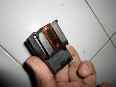

For Black Cartridge:

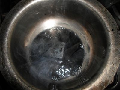

1) Heat water around 1/3rd the height of the cartridge (Do not boil the water)
2) Dip the head of the cartridge in it.
3) Agitate the water with the cartridge and the water turns black.

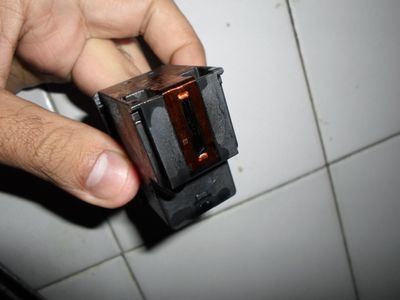

4) After 5 minutes use a tissue paper on the head to check whether it is unclogged.
5) Now remove the cartridge, dry it thoroughly and remove the water from the foam in the cartridge with a medical syringe.

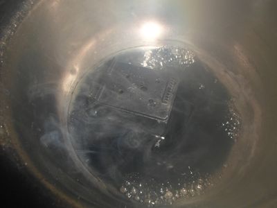

For Colour Cartridge:
1) As the colour cartridge has three colours so all the colours mix so replace the water frequently and do this practice more than 5 times. Follow instructions 4 & 5.
