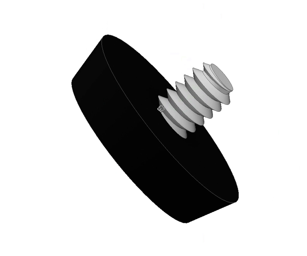

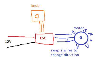

It was not enough for me, so I put a high speed fan for extreme cooling. I used a brushless motor and printed a fan on the 3d printer, and printed a case, materials used below:
- 12V power adapter
- Servo Tester
- 10-20A ESC
- Power the world motor
The links will be in the last step when you are ready to get started.
Step 1: 3d Printed Fan.
The fan and case are drawn, and then 3d printed. I was not sure if it would work or if it would spin and explode, but it works beautifully and I did not have to do any balancing, only the normal clean it up after the print.
