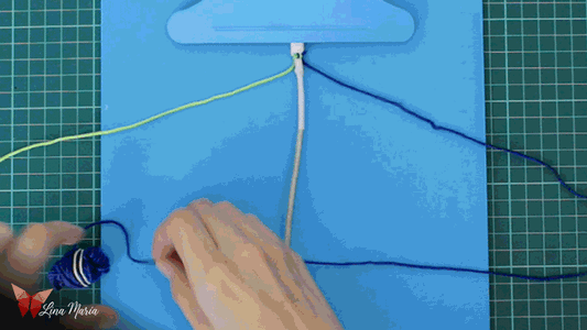

Step 5: Covering the Cable
This is how to make the weave to cover the cable:
  1. The thread that is on the right (the blue one), pass it to the left side over the cable.
  2. Pass the thread on the left (the green one) over the thread from the right (the blue one)
  3. Pass the left thread (the green one) under the cable to the right side
  4. Pass the thread from the left (green) inside the thread on the right (blue)
  5. Pull the threads to tighten the knot
Step 6:
Every time you tie a knot, the colors of the threads will be inverted, it is important that you always start the knot with the thread that is on the right side, no matter what color it is.
Step 7:
When you have made so many knots that the cable is completely covered, make two (normal) knots to finish and cut the excess thread.
