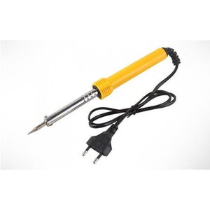

  • Soldering iron

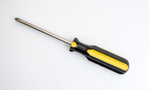

  • Phillips (Torx) head screwdriver

The body of an optical mouse is made up of two major plastic parts, which we are going to call lower and upper halves. The upper half has additional smaller parts, aka the buttons and scroll-wheel. The lower half is where you will find the holes of the screws holding the mouse together. We need to remove these screws so we can work on the PCB. You will find that most mouse use Phillips head screws, but you might encounter ones using Torx head screws. It's good to have the right screwdrivers ready. Usually the screws are hidden under labels or plastic feet. There should be around 2 or 3 that you need to remove. After removing the screws, separate the plastic parts. Now the PCB should be visible. If it is held in place by screws, remove those as well, and take the PCB out.

You can order the necessary parts online, or you can do as I did and harvest some from a dead mouse. (a mouse is dead if the main IC is fried) The process of disassembly is the same for the donor mouse. Prepare your soldering iron and start removing the necessary components. Removing the switches is fairly straightforward as they only have 3 legs, the rotary encoder might be a little bit more difficult. Older mouse's use solder that's easier to melt, with some newer mouse's you might need to heat the board with a heat gun to be able to melt the solder.
Step 4: Replacing the Broken Components
Remove the broken components from the PCB and install the new ones. As we have already seen when desoldering them, microswitches are pretty easy to work with, however rotary encoders might be a little bit trickier, as they have 5 legs, and the 3 in the middle bend easily, so inserting them into the proper holes in the pcb is fiddly work. Once inserted however, soldering them is a breeze.
