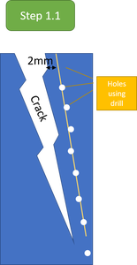

1. Planning and drilling the first set of holes
  • Aim to leave at least a 2mm gap between the edge of the crack and the outer of the hole, and more if you feel the material isn't thick/strong enough and that the thread might just rip through the material.
  • If beauty is of importance- mark the holes in advance using a contrasting marker/paint to make sure they are equidistant.
  • Visualize the pattern that you wish to see in the chair after the stitch and plan the holes accordingly.

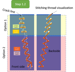

2. Drilling the holes on the other side
  • The gap between the hole and the crack and also between holes is as on the first side.
  • The second side can have holes either in line with the first side (option 1), or slightly vertically offset (option 2)- based on your plan.
  • Whether you choose option 1 or 2 or any other fancy stitch, please remember the goal- to exert a force perpendicular to the crack at every point possible.

1. Decide the start point and start the stitch
Start from a side that is towards an end and has some space in the back that isn't well exposed so as to keep the splicing hidden from plain sight.
Based on the thread/wire, the starting and ending knot might need improvisation- I just had them twisted and it was sufficiently secured. Nylon thread users might need to melt the ends for a more secure stitching experience.
2. During the stitching
Tighten every stitch as you proceed, place a finger on the tightened running line after you've tightened it to sufficient tension(nylon thread users to be extra cautious here, metalcore wire will hold the tension sufficiently without much aid). The goal is to uniformly apply just enough tension to keep the pieces well pressed together- not too much (that the 2mm plastic in between gives way or the thread/wire breaks) nor too little (that there is slack in the stitches and it moves).
Any experience in gutting badminton rackets by hand helps here :)
3. Perform the necessary number of runs
Do a single run or two runs, as per design and reinforcement need. I did two runs because I had enough wire and I wanted added strength because the shielded copper wire isn't the strongest.
4. End with a secure knot
If ending at the start point after a 2nd run, use the start end to knot/splice well to the running end. Use the epoxy or melt off the end as needed to secure the knots.
Note, if the plan for multiple runs exist- check for the dia of the thread/wire and the hole that's drilled- make sure (dia of thread/wire): (drill bit dia) is at least 1:2. I used a 0.6mm shielded wire of which the shield was flexible, and I have been able to make about 4 entries into a single hole drilled by the 1mm bit. This also says that the 1mm drill bit might be slightly bigger than 1mm.
