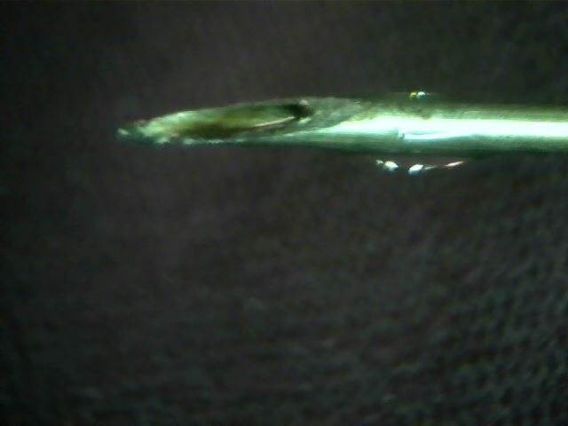

Step 4: The Trick...
Now, going on about a 45 degree angle from one of the upper holes, punch the needle through the sticker and rubber grommet and squeeze in some oil.
If there is no rubber grommet, the oil may start to leak out the hole you just made...as soon as it does, remove the needle.
If there is a rubber grommet, just squeeze oil in and remove the syringe as you do so. The grommet will seal up as soon as the needle comes out.
Now power up the unit, and let the oil work its way into the bearing.
Fans with rubber grommets last years after doing this. Those without vary in how long they last afterwards - but hey, you can just do it again down the road!
If you can manage to get some tape over the hole you made, it'll last longer than if you don't.
If the fan is one that has completely seized up, you'll need to move the blades back and forth until the fan starts to spin on it's own. I find a Popsicle stick is good for this procedure.
