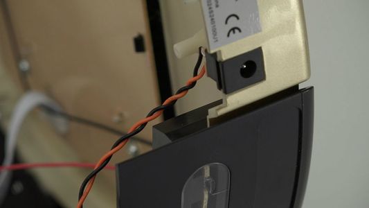

Step 2: Disconnect the Cover
Slide the power inlet on Bob's side out of its holder.
Disconnect three circuit plugs which attach the cover components to Bob's main board.
  1. The multicoloured connector at the top right side of the main board.
  2. The red, black, and while plug on the bottom left of the main board.
  3. The all white circuit plug to the right of the previous connector.
Set the cover aside.
