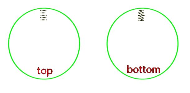

grab your nylon/fishing line and cut a length to your desire.
in stitching the Frisbee/Disc you could use the given pattern i have attached for your convenience.
