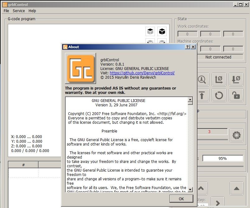

Introduction: Fix for Image Not Showing in GrblControl When Using Inkscape With 305 Engineers GCode Generator Extension.
When I first started using GRBLControl with GCode generated by the 305 Engineers GCode Generator for Inkscape extension, the image would not appear in the visualiser window.
The code would appear in the bottom window but no image.
This little edit of the 305 Engineers .py extension file fixes it.
