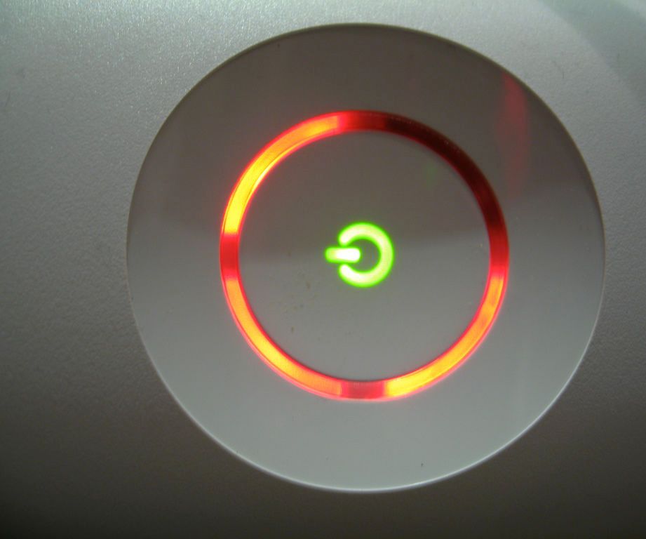

Introduction: Fix the Red Ring of Death! (Without Towels)
Fix your Xbox 360's Red Ring of Death (RRoD) by yourself, no wrapping in towels or soldering irons required! If you no longer have a warranty on your Xbox 360 and it has developed the dreaded Red Ring, there is hope. You can still easily repair it.
As most of you know, the RRoD is a sign displayed by the 360's "Ring of Light" when there is a general hardware failure. While this can be caused by any part (or lack thereof) of the 360, the general cause is most often excessive heat, which stresses the solder joints on the CPU and GPU. Over time, these joints can become separated, which causes the Red Ring to appear after a few years of use, usually when you have a new game to play and you've taken the day off.
This method requires nothing but mere screws and washers. Seriously: no overheating your console, no adding new fans (although you can add them if you like), no towels. Ever since I did this I haven't had the console freeze up once.

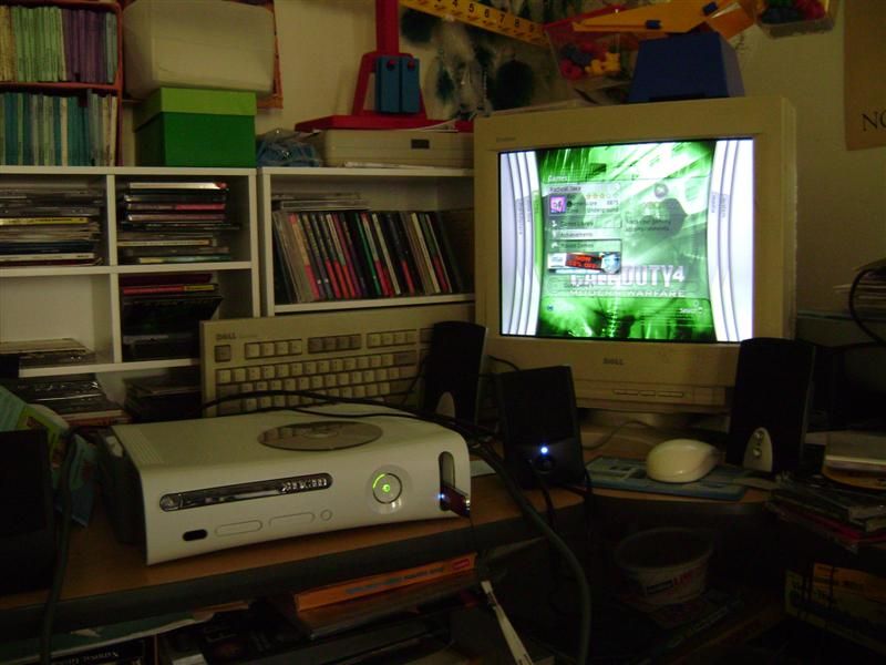

Now we get to test it out!
Step 9: Testing, Testing, Three, Six, Tee...
Hook your 360's AV and power cable in and plug the RF board (the circuit board that has the Ring of Light LEDs) back into the 360. Otherwise you won't be turning it on. :D
Turn it on without the fans plugged in, checking to see how fast the heatsinks heat up. Getting hot in less than a minute is excellent. Now plug in the fans and put on that plastic fan shroud. Turn it on again and it should boot up normally, assuming you did the heat test (if you didn't plug in the DVD drive, the center LED will blink green).
If it goes RRoD instead, unplug the power cable, re-insert it and try again. If you cannot get the console to boot, press down on both the heatsinks with even force and power it on again. If it boots, power it on with only one heatsink pressed upon. If it boots with that particular heatsink pressed on, power the 360 off and keep re-booting until you find the problem corner(s) on the heatsink that needs tightening.
The idea is to tighten any heatsink corners that aren't tight enough in order to allow a good connection for that processor.
So if it boots up normally and you can play a game for at least an hour without it locking up, you've worked your magic and the 360 can be re-assembled! Have a beer, rent a movie, eat some gummy bears, do whatever it is you do to treat yourself because YOU DID IT!
