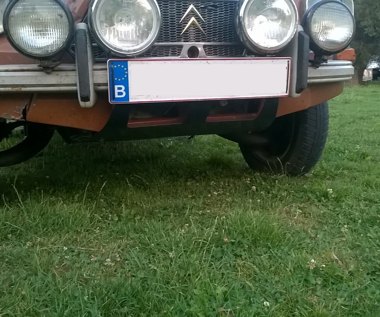

Introduction: Fix the Reflective Layer on a Rear Light
I'm working on a 1967 Citroen Ami 6.
The reflective layer on the rear light bulp holders is almost completely gone.
In this instructable I'll explain how i fixed this.
