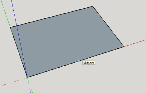

One of the fun things with sketchup is it pretty intuitively snaps to where you need it to as you build (mid-points, recently of frequently used lengths in the past few steps, nearby corners, points, offset planes etc.) The issue is that sometimes those guesses are slightly off, and even though it looks fine, you can be off by a fraction of a degree or a fraction of a mm.
Now what happens when you are off by a fraction of a mm off line or a fraction of a degree off plane? Well, as you keep building up, all those nice handy features of automatically snapping things eventually snap on to this off-design point, and the errors start compounding. This is even more likely if you use curved shapes.

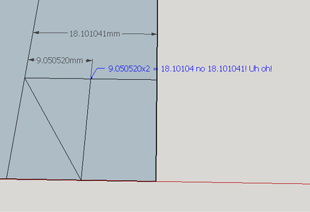

As you keep building, all of those extra points have been added, and you don't know which part of your model is out of phase or not. Trying to backtrack and find them all and put the new lines in the right place is nearly impossible and quite frankly not worth it. This is why my recommendation is to rebuild parts of, or the entire design.
In the picture above, you can see that I got to a bad midpoint because of software rounding errors when I did it through multiple steps.
