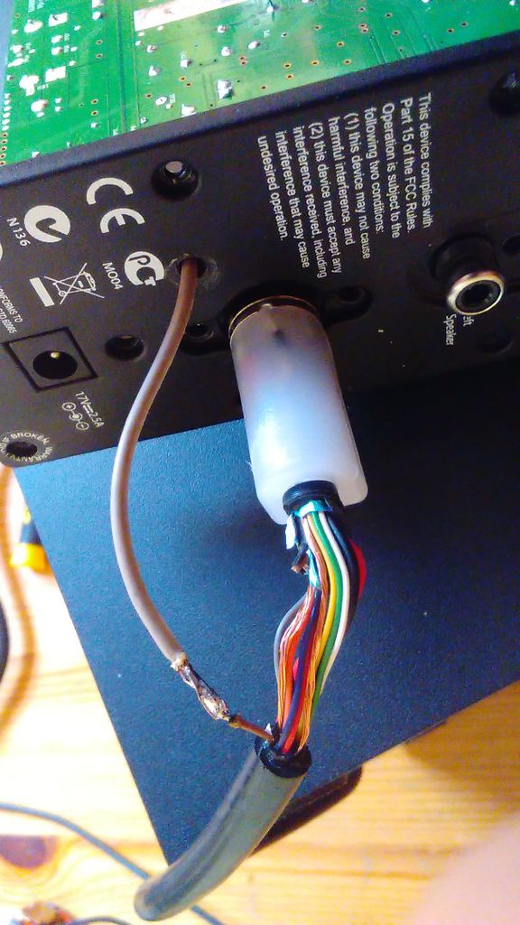

    I decided to take your repair one step further and try to diagnose the cause. Using your instructable as a starting point, I discovered 4-14 volts throughout the left channel circuitry. Upon tear down of sub-woofer, I located a problem on the male 13 pin DIN plug. The left channel pin and the 17 volt power pin are next to each other and voltage was leaking over into the left channel.
    I cut open the DIN cable, located the brown left speaker wire and cut it. Then I broke off the left speaker pin in DIN plug so the voltage leak wouldn't feed into the sub-woofer PCB. I opened up the sub and soldered a wire to left speaker DIN connection point on PCB. I drilled a hole though mounting plate, fed this wire through and soldered it to the brown left speaker wire I cut previously. Now I don't have such high voltages on the left speaker circuit and the SP-2200 set sounds great once again. Hopefully this is the cause and my fix holds up.

    Ok so I found the 17V alimentation wire: it's the white one. I did the same manipulation as I ddid for the left speaker one, and now I don't have anymore crackling AT ALL :)
    So I advise to deviate the 17v wire only. Some pictures again: The 17v broken pin (middle right (the bottom right is the left speaker one I broke before (see post below)), not needed but I preferred to break it anyway ^^), the PCB soldering corresponding to the 17v wire (left one (white wire too)), and the wire soldering (white-white).
    Don't forget to isolate everything with glue and tape!
    Enjoy :)

    Okay so I did it and... it worked! And my set was crackling in all speakers (right, left and subwoofer) so loudly I couldn't even hear the sound it played, it was even crackling when it was off...
    However I still have a very light "wind" and cracklings in the right speaker, and just a bit of wind in the left, but it's independant of the volume now, and so low I can't hear it even when nothing plays.
    Maybe it's because the 17v power pin is leaking on other pins, and we should deviate it instead of deviating the left speaker, however I don't know which one it is, can you help me here RabidShepherd? :)
    I took some pictures to make it more understandable:
    The brown wire (the cut one).
    The corresponding pin in the DIN plug (the missing one, bottom left on the picture)
    The corresponding soldering on the PCB
    And the soldering on the brown wire.
    IMG_20150820_101312.jpgIMG_20150820_102758.jpgIMG_20150820_105144.jpgIMG_20150820_105109.jpg
