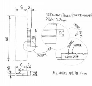

    Step 2: The Concept. Tools and Manufacturing. CNC or Needle Files?
    I hope this step will be simple enough for everyone who will try to reproduce the fixture. The fixture will be glued firmly to the LCD glass from behind, then thin wires will be soldered to the fixture pads and finally the end of the wires will be glued to the LCD contact pads with conductive glue. Feel free to use the attached mechanical drawing to understand the idea better. It shows the fixture dimensions (mm scale). Please note the LCD pitch is very close to 1.2mm.
    Because I had the opportunity, I decided to use a hobby grade CNC to manufacture the fixture, but - as described before - this fixture can be manufactured manually using a jigsaw, some needle files and a cutter. The base material can be any small piece of single sided, 1.6mm thick PCB. For those who are interested in CNC machining there are two basic g-code files attached to this step. One is for the fixture itself, the second is for scoring the pads. Machining time is 5 minutes for the fixture and one and a half minute for scoring (without counting the tool change and leveling). The first g-code program presumes a 2mm PCB end-mill (can be found on e-bay searching for "Carbide End Mill Engraving Bits for CNC PCB Rotary Burrs 0.5 to 3.175mm" or similar) the second program uses a 0.2mm engraving bit (can be found on e-bay searching for "2x Titanium Coated Carbide PCB Engraving CNC Bit Router Tool 30 Degree 0.2mm" or similar). The scoring depth is set to 0.2mm. Please note that the g-code files are more like amateur approaches than professional ones, but they do the job well. The result is shown in the picture.

    Once the fixture was machined, I made a basic alignment test to see how it fits to the LCD. The result was satisfying enough to go forward and glue the fixture to the LCD. For this I used a very common superglue (Picatura) and a needle.
