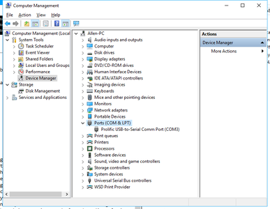

Before plugging in the USB cable, you'll need to install the Prolific Drivers. Just extract them, right click on ser2pl.inf and install. These will work on Windows 7 - Windows 10. Depending on your version of windows, you'll likely have to accept some permissions. Now when you plug in the USB device it should be detected. You can right click on This PC in explorer, select manage and go to Device Manager. You can expand on ports and you should see the Prolific USB to Serial Comm Port with a number after it. Note the COM number. If you see a yellow exclamation mark, just right click on the device, update driver, browse my computer, let me pick form a list, have disk, browse for the ser2pl.inf file you downloaded and click open.

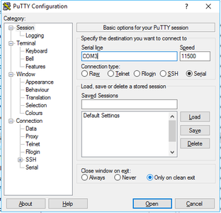

Any terminal emulator software will work, but I like Putty. Just download it and run it, you don't have to install it but you can if you want. Choose connection type Serial, Speed set to 115000 and enter the COM# from your device manager you found the the previous step. (WARNING, when you camera powers on, it may try to spin which could result in it rolling off your desk, hitting the floor, tearing off your cable and destroying your camera. Be careful and make sure this doesn't happen by holding it in your hand or just placing it carefully on your work space.) Click open to start the connection and then plug in the Ethernet and finally the power cable (2nd WARNING to make sure your camera doesn't fall of your desk!). If all is connected correctly, you'll see text streaming across your screen. If not, go back and check all of your connections.

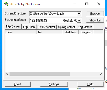

Choose whatever folder you're using to store the files (I just used my download folder) and set the server interface if you have more than one network card. This tiny server will host your files so that your camera can pull them.

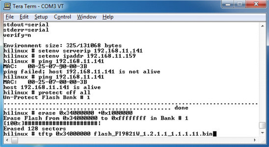

protect off all (Disables memory protection erase 0x34000000 +0x1000000 (Watch your spacing, it has to be exactly the same to work. It should take a few seconds to erase all of the memory from 0x34 to 0x1)

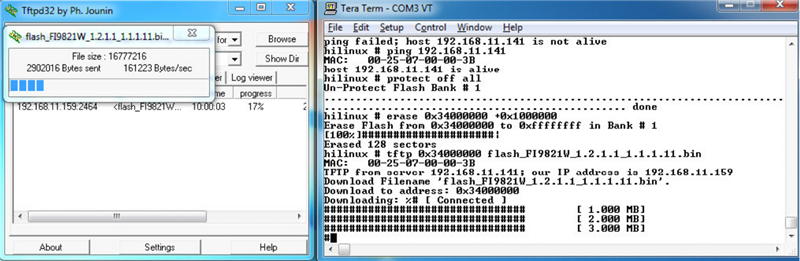

tftp 0x34000000 flash_FI9821W_1.2.1.1_1.1.1.13.bin (This should start transferring the file from your computer to the camera. TFTP should show you progress as well.
reset (reboots your camera)

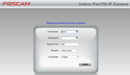

Step 10: Access the Camera Via Your Web Browser
The camera is going to grab a new address from DHCP so you can use the ifconfig command to see what that address is, or you can use the Foscam IP CAM tool to scan for it. Once you find the new address type it into your web browser http://192.168.0.51:88 (88 is the web port for these cameras) Now you should see the standard interface. The username is admin and there is no password. Click Login and you should see the Device information screen.

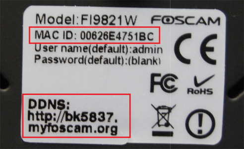

Step 11: Reset the DDNS and MAC

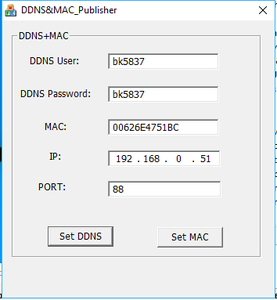

Now you need to reset the DDNS and Mac to get it all back to normal. Run the DDNS&MAC Publisher.exe file. Look at the bottom cover of your camera for this information. Enter in your DDNS username, something like bk5837 and enter the same for your DDNS password. Enter in your MAC as numbers and letters only, something like 00626E4751BC. Then enter in your camera's IP address and port 88. Press Set DDNS first, and it should say 'Process OK' then Set MAC and get another 'Process OK.' Refresh your web browser and you should see the right camera ID.

Bonus, if you can't see the camera in Chrome, just install Foscam Web Components and IE Tab in Chrome. Then you can pull of the camera's page in Chrome via the IE Tab extension and your camera should work. Also, IP Cam Viewer for Android and IOS gives you full PTZ control of the camera or you can use the Foscam app.
