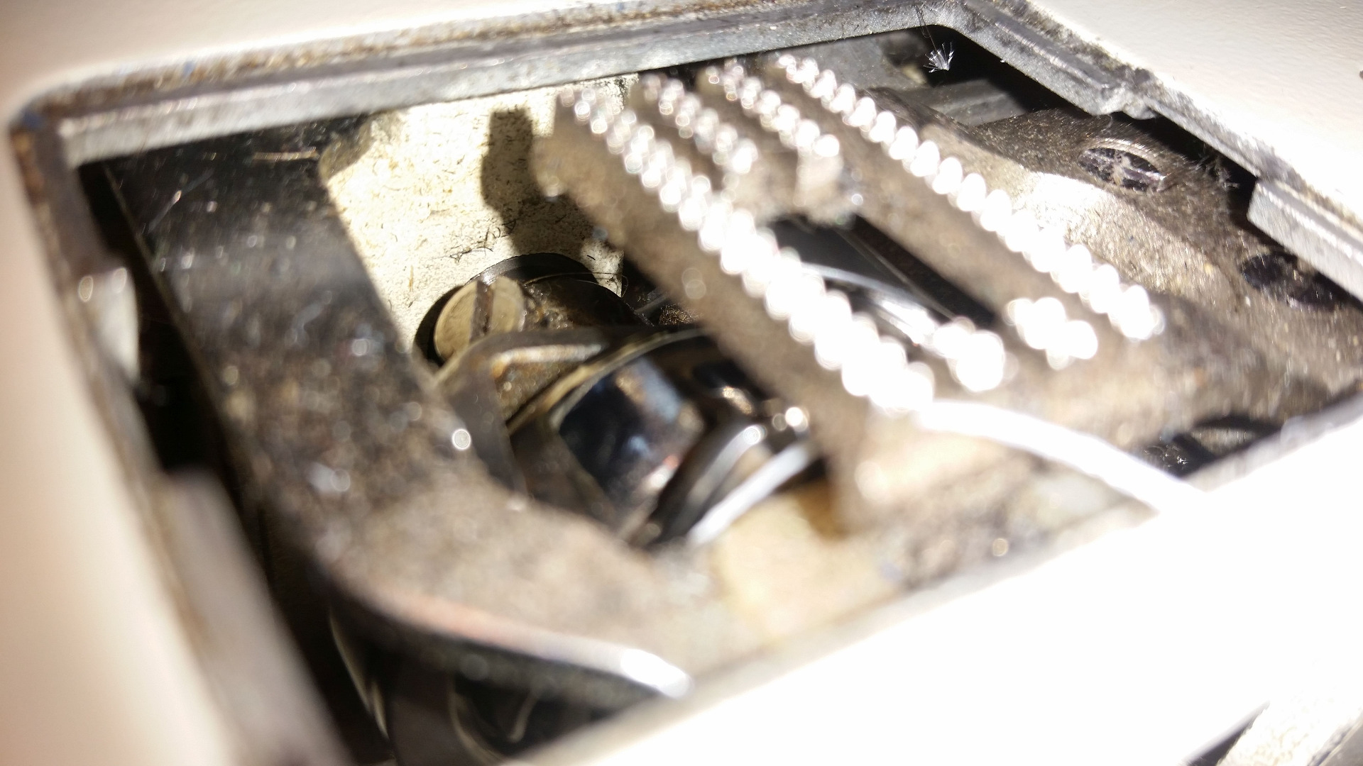

This is how it looked before the crash:
And here you can see that after breaking the needle it now get's stuck.
For you it might be that the needle is hitting the outer rim somewhere or that it is stuck in a different place.
In this pic you can see one of the three screws holding the hook mechanism on the spinning axle:
Loosen these screws but only only so that they still hold all in place.
When you can moove the mechanism with sligh pressure it is good.
As you could already see in the first video the needle needs to be in front of the hook on the way up.
