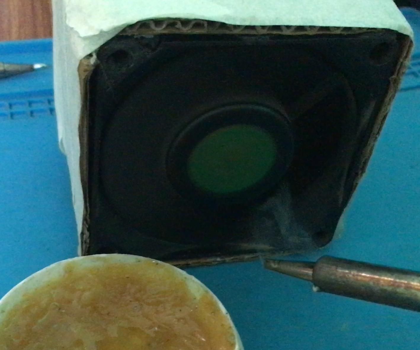

4.When soldering either do it on a well-ventilated space or use something like a fume extractor or fan to get rid of the fumes.
