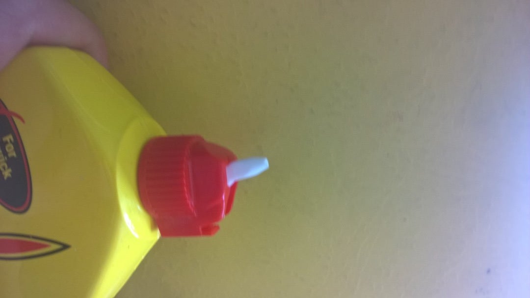

Step 4: Prepare the Butane
Purchase a bottle of lighter fluid specifically for lighters. I used the Ronsonal brand. I prefer this brand because the top of the bottle fits perfectly into the hole for the fuel in the Zippo. Open the top of the lighter fluid so the spout is pointing up and ready to dispense lighter fluid.
Step 5: Fuel It!
Identify the small hole in the middle of the soft bottom of the lighter. Place the applicator of the lighter fluid in the hole and allow the fluid to flow into the lighter until the bottom of the lighter becomes visibly damp.
