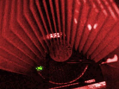

I burnt my hand on the massive heat sink for the CPU and realized that the whole computer is really hot, after a quick and technical airflow test (sticking my hands in different places) I figured out that the single massive fan at the front isn't pushing enough air out the back vents, thankfully it's all pretty clean inside since the fan pulls in from the front vent that is six inches off the floor, rather than the usual floor level ones.

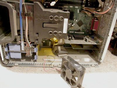

This is very easy, bring the computer out so there's space either side of it, now pull the handle on the back backwards, straight back, you'll encounter a bit of resistance at the last bit, pull it right back and the side of the case pops right off, dead simple.

Now You'll be able to see a large black tunnel box with a giant heat sink in it, this is our problem area, however adding the fan on to the end of that would cause issue and possibly not solve the problem at hand, since there is a heat sink just behind it which is honestly too small for the chip it's on, combine this with the fact that it's in the shadow of the larger heat sink it gets little air flow.
Unless you actually have a need to remove the black air box you really shouldn't, the heatsink for the CPU is attached to this and you'd need to re-apply thermal compound to it after removal. For reference the box is removed by unscrewing the two starhead screws near the front of the box, it then hinges backward towards you and pops off.
The back grille is relatively clear and free of obstructions and is a good place for the fan, being the main exit for air we basically augment the original system without fundamentally changing the airflow characteristics.

Once safely grounded take your wire and tie a knot near one end, pull the rest through a hole in the fan and loop across and back through the next hole and through the grill, pulling it tight as you go, once you've come to the last corner needing secure by pulling it through the an and grill, put a loop in through the grill and tie a knot on to the grill.

To wire the fan up we'll need a molex connector with nothing in it, thankfully there should be one dangling above the big heat sink we were looking at.
If you have a connector then job done.
If not you'll need to either extend the leads of the fan by soldering on some wires, if you solder on some wires, remember to use heat shrink wrapping or tape to insulate connections, just in case they hit the mobo and cause a short and possible destruction in the computers squishy innards.
Hook it up and test it's running, to figure out how to make the most use of a single fan I did all of this modification with the computer running, you needn't risk doing so since I've done the dumb stuff on this one.
