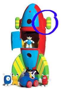

Originally, this rocket ship had these odd 'winglets' that protruded from the sides of the ship; [seen in example image] these were removed long ago for its prior use. This left behind some cavities that need patching. For this I used Milliput, a 2 part epoxy clay.
Milliput has a long working time and sticks to pretty much anything, giving plenty of time to patch each side. I patched one side first, let it cure, then patched the other and lined them up to touch to form a new seam, using plenty of water to make sure they don't bond to each other.
After every patch is cured, sand with files and sandpaper. Milliput sands like a dream and only takes a few minutes for a smooth, uniform surface. After that, a spritze of primer shows how the seam would look once painted.
