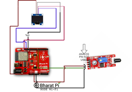

Hardware Connections
  1. Flame Sensor:
  2. VCC → Connect to the 3.3V or 5V pin of the Bharat Pi board.
  3. GND → Connect to the GND pin of the Bharat Pi board.
  4. DO (Digital Output) → Connect to GPIO27 of the Bharat Pi board.
  5. OLED Display:
  6. VCC → Connect to the 3.3V pin of the Bharat Pi board.
  7. GND → Connect to the GND pin of the Bharat Pi board.
  8. SCL (Clock) → Connect to GPIO3 (I2C SCL pin).
  9. SDA (Data) → Connect to GPIO2 (I2C SDA pin).
Diagram Description
  1. The flame sensor detects the presence of a flame and sends a digital signal (LOW for flame detected, HIGH for no flame) to GPIO27.
  2. The OLED display communicates with the Bharat Pi board over the I2C protocol using GPIO2 and GPIO3 for data exchange.
