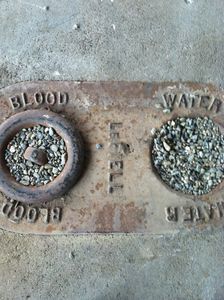

Step 2: So Lets Get Started!
First you want to have the proper facilities. I like mine to have separate drains for both water and blood.
