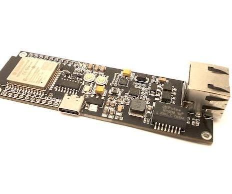

This is a tutorial on how to make a gas detector / alarm using an ESP32-Stick-POE-P. The basic idea is that there will be a flammable gas sensor which if triggered sends an email to let you know.
Step 1: Connecting
If your MQ-2 has 4 PINs and not 3 than use analog PIN (commonly marked with letter A)
Than just connect your ESP32 to USB-C and Ethernet cable and we're done with connecting
