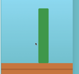

Step 3: Flappy Instructable Game in Action
Place the .html code and the Instructable Robot image in the same folder. Open the .html file in a web browser and enjoy playing.
