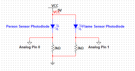

Step 3: Solder the Sensors
The light sensors work by comparing their resistance (dependent one the amount of light hitting the sensor) to a set value resistor. As the resistance of the sensor changes, the the voltage at the point between the light sensor and resistor changes. This voltage can be read by the arduino.
For this project, solder the light sensor on the end of a wire long enough to reach where it is needed. It is also good to use some heat shrink tubing around the bare wires at the end, because of the moisture in the pumpkin.
Next, expose a portion of the wire that connects to the negative sensor lead (the one to be read by the arduino). Solder one side of the resistor to the wire near the cut. The other side of the resistor needs to be soldered to the ground.
See the schematic below in the pictures for clarification and for the pins on the arduino to connect.
Solder all of the connections to go to the arduino (+5V, ground and 2 sensors) to the header, so it can be easily removed later.

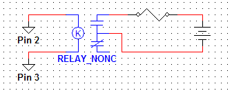

Step 4: Build the Gas Supply
To construct the gas supply, start by disassembling the BBQ lighter and removing the gas container and lines.
Once that is finished, use hot glue and attach the solenoid to the gas. Attach it so that when the solenoid is activated, the gas opens. You may need to modify the solenoid so that it fits the gas supply, and so it has enough strength to turn on the gas. I modified mine (from a broken record player) by removing the spring, and flattening the spring anchors. I also added some neodymium magnets to help the strength of the solenoid.
Once that works reliably, connect the relay so that when it switches on, it completes the loop between the 24V adapter and the solenoid. See the electrical diagram in the pictures to help clarify things.
