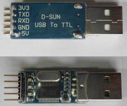

a. USB to TTL Tx - ESP Rx
b. USB to TTL Rx - ESP Tx
c. USB to TTL 3.3V - ESP VCC & CH_PD (ESP01 is 5V intolerant!)
d. USB to TTL GND - ESP GND & GPIO0 (Take note of this pin, it should be removed when sending AT commands later on, for now just keep it plugged)
