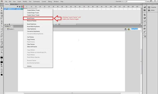

Step 6: Animating With Ones, Twos or Threes
You can drag your frames out by right clicking the frame you want and choosing the option "Insert frame". This will double the length of the frame making you animate in twos. If you drag it out by three frames you are animating in threes.

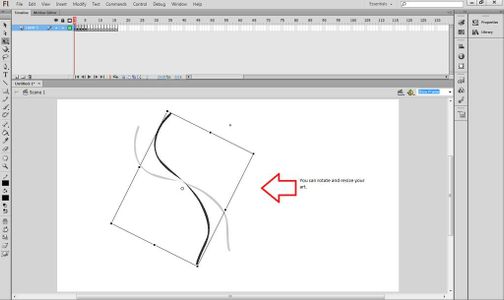

Step 7: Tools: Selection Tool (V)
When you have the selection tool on you can highlight your art. From this point you can do a lot of things, like delete the art you have selected by hitting the DEL/BACKSPACE button on your keyboard, Or you can right click and go to "Free Transform". Now you can resize your art, rotate, or scale (Hold shift whilst rescaling it so it wont stretch or distort your art). Envelope is also a useful tool and you can get to it by selecting your art, right click, and clicking on "Envelope". Using envelope will allow you to warp your art in any way you wish.
