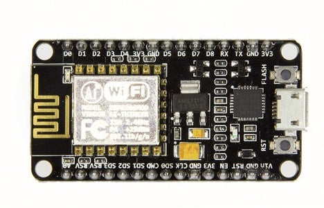

- If you plan to flash a NodeMCU: NodeMCU module

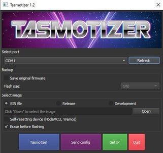

Step 1: Install Flashing Tool
To flash your micro-controller with WLED, you will require a computer with a flashing tool. For this instructable we will be using a Windows machine with the Tasmotizer flashing tool, but you can achieve the same with Mac & Tasmotizer or other flashing tools like Esptool.
- Download the latest version of Tasmotizer:
- For Windows download and install the latest standalone .exe from Github.
- For macOS refer to this guide.
- After installing Tasmotizer the program can be opened and should look something like the attached photo.

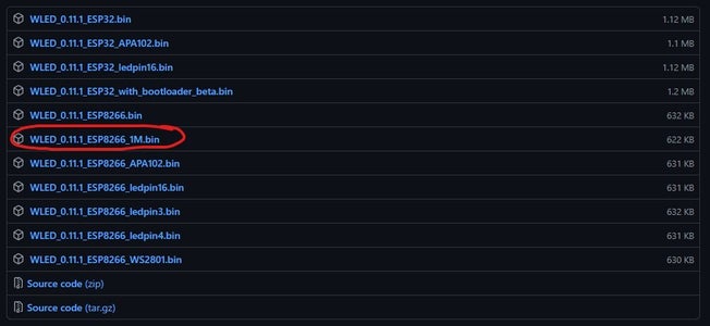

Step 2: Download WLED
Download the latest version of the WLED binary from the releases page.
Depending on your micro-controller you can select an appropriate binary file to download.
Since I will be focusing on the ESP8266 variants, I will select the "WLED_0.11.1_ESP8266_1M.bin" file.
Download the file and save it on your computer at a known location for later use.

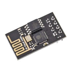

Step 3: Prepare Micro-controller (ESP-01 Module)
As previously mentioned, I will be focusing on getting the ESP-01 module or a NodeMCU flashed with WLED in this instructable. In this step, we will be preparing the ESP-01 module. In the next step, the NodeMCU.
I've made an instructable for flashing an ESP-01 board using Tasmota and Tasmotizer. The instructable can be found at this link. The process of flashing the ESP-01 board using WLED is exactly the same, but we substitute Tasmota with WLED.
- Replicate the "Step 2: Hardware Setup" step in my other instructable.
- With the ESP-01 module in "flash mode" you are ready to open Tasmotizer and flash WLED.
Step 4: Prepare Micro-controller (NodeMCU)
In this step, we will be preparing a NodeMCU to be flashed with the WLED library.
Note if you experience any difficulty connecting your NodeMCU to Tasmotizer, consider installing the CH304G diver on your computer. I found a great tutorial on Sparkfun for installing the driver.
If you don't encounter any connection issues with connecting your NodeMCU to your computer, it is as simple as connecting your NodeMCU via micro-USB cable to your computer.
You are now ready to flash your NodeMCU with WLED.

- Open Tasmotizer.

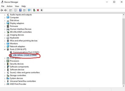

- Make sure you select the port of your connected micro-controller. On Windows, you can find the port by navigating to "Device Manager" and looking for a CH340 device under "Ports"
- In Tasmotizer under the "Select image" section, make sure "Bin file" is selected.
- Click on "Open"
- Select the appropriate .bin file for the micro-controller you are about to flash. For this example, I will be flashing the ESP-01 module with the WLED version 0.11.1 WLED_0.11.1_ESP8266_1M.bin file.
- Click "Tasmotize" and wait for the process to finish.
