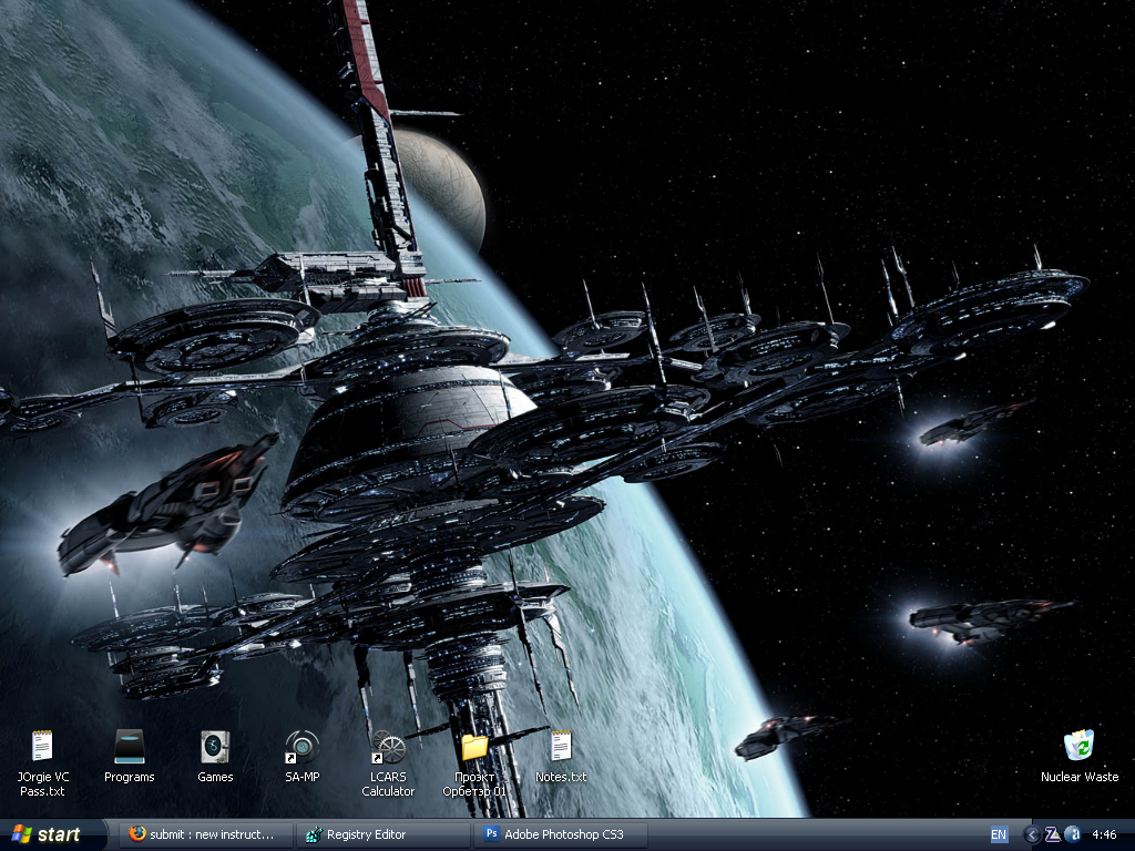

Step 4: Then You're Done!
You're done. You can show off at your school's computer lab, in your friend's home or even in your office.
