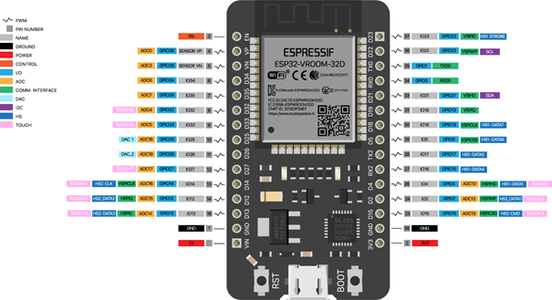

  2. ESP32 Development Board

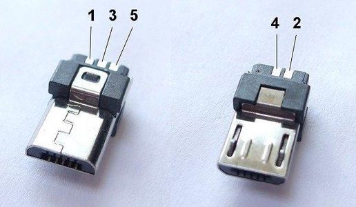

  3. Micro USB Cable

  1. Connect ESP32 to Laptop/PC
  2. Identify the COM port to which the ESP32 is connected

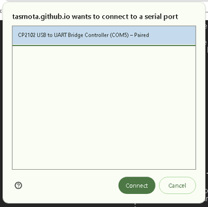

  3. It is not time to connect to your serial port (COM5 in this case. Please note that the port number may be different in your case.
  4. Select the listed ("CP2102 USB to UART Bridge Controller (COM5) - Paired" in this case) and hit "Connect".
  5. You may encounter an error (Serial Port is not ready). Close any other application using it and try again.
  6. Repeat the steps in S.No. 2 & 3. If everything goes well, you will be prompted to "INSTALL TASMOTA (ENGLISH)"

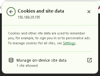

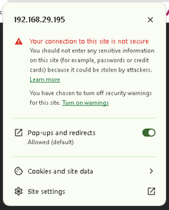

  5. "The connection to 192.168.29.195 is not secure" > Hit on "Continue to site" to continue. You will be redirected to the Tasmota Home Screen.
Note: While you move the cursor over "VISIT DEVICE", you can observe an IP address in the bottom left corner of your web page. You will be taken to this IP address by selecting "VISIT DEVICE". In my case, my home router has allocated an IP address: 192.168.29.195.

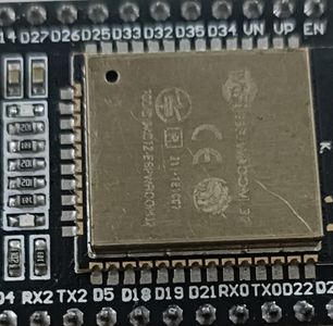

Note: An ESP32 is a microcontroller chip with a built-in 2.4 GHz Wi-Fi radio. It can connect to wireless networks operating on the 2.4 GHz frequency band. ESP32 is designed to work with standard 2.4 GHz Wi-Fi networks commonly used in most homes and devices.
