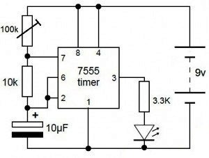

Step 2: Testing the Circuit on Breadboard
Now that you have got all components you test your circuit before soldering it all together.
I do it with all my projects and it saves both effort and time. Anyways I have attached circuit of bread board.
The push button is added after the +ve voltage for turning the heart on/off.
When your special person takes the gift he/she will press the push button for turning the circuit on/off.
It is simple and I have used breadboard just for testing. It is entirely up to you. This step is optional.

Step 6: What the Heart Does After Pressing the Push Button
This is a flasher circuit attached to the LED heart so it blinks very
fast then it slows down its rate. It continuously keeps on flashing and changing speed of flashing. Your friend will love it. Good Luck!
