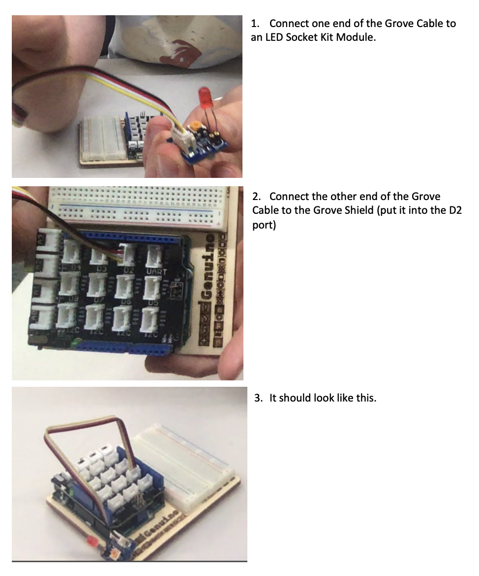

Step 1: Build Circuit
A PDF of the instructions is provided below.

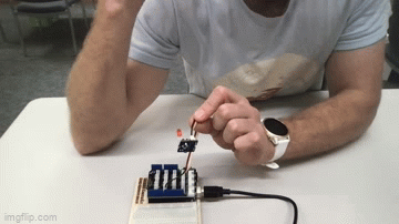

Step 3: Run the Program
Once you push UPLOAD, the lights should start flashing. A PDF of these uploading instructions with images and info is given below.
