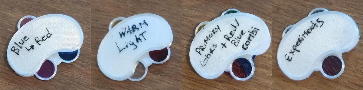

Red / Blue filter
A filter colored 50% with blue ink, 50% with red ink
Experiments
Multiple versions that hold different filter experiments

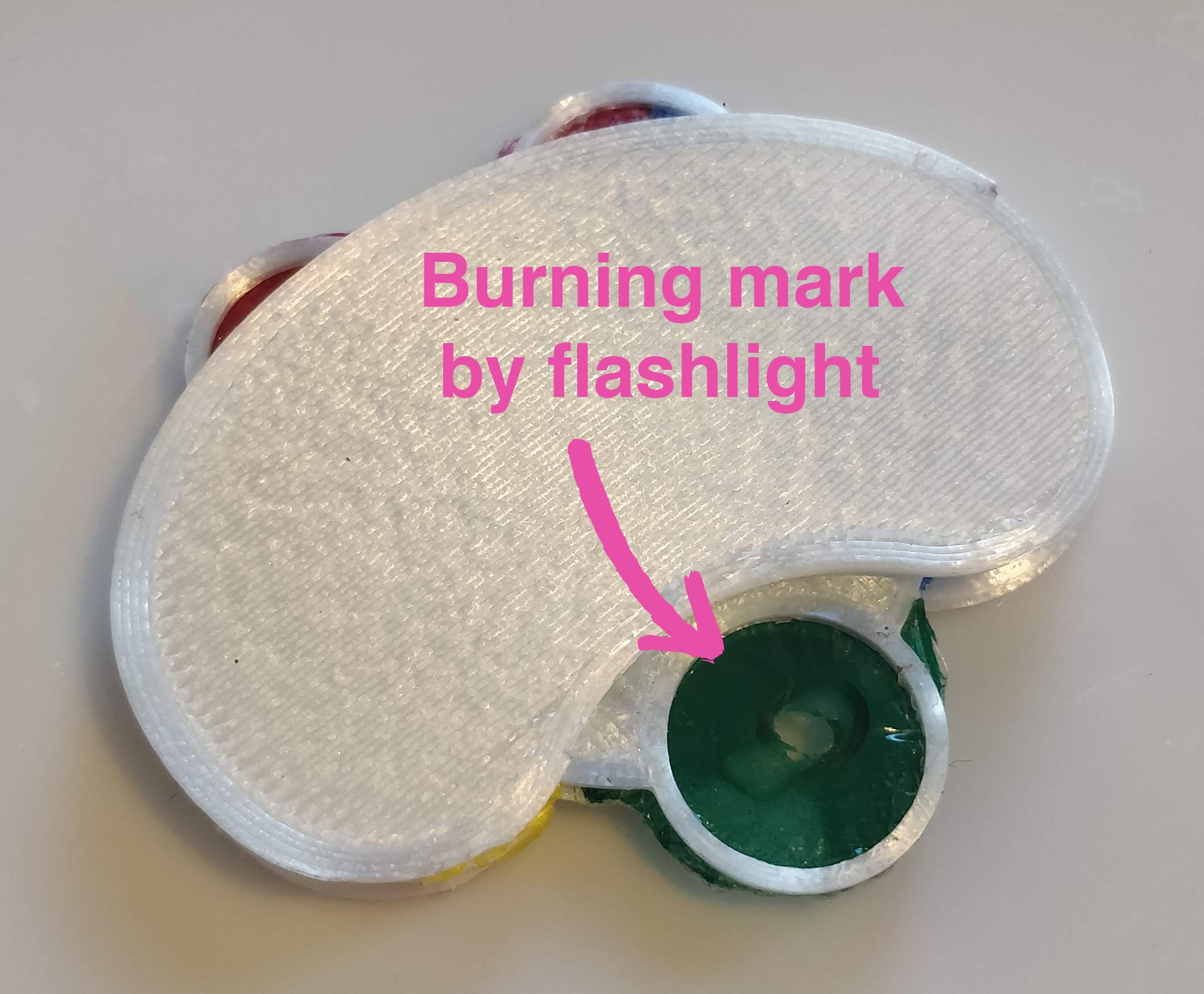

Burned filter
When I was using the filter with the flashlight on for a longer period of time, the heat of the LED started to melt the filter. I expect that this is due to do material I have used for the filter. I was using a very thin plastic film that isn't designed for these use cases. I haven't done the experiments, but I expect that using a different type of transparent plastic will resolve this issue. The easiest way to test it is to simply hold a lighter next to it for 5 seconds, and see how the material responds to it. If it immediately start to crumble away, you'll know that it won't withstand the heat of the LED for sure.
