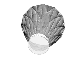

To make sure all your settings are correct, print a small test print at 0.25 scale. This only took about 15 minutes and gives a perfect representation of our final product. You might notice that this test print looks a little different. That's because I decided to spice mine up a little bit before I went full scale. Here's how:
Step 9: Getting Fancy
After designing this, I realized that I was basically building a vase. I knew there were many customizable vase applications out there, so I wanted to see how easy it would be to make a little fancier version of this lamp. Turns out it was really easy. Go here and enter in a few parameters. Make the top the same size as your flashlight lens. Then adjust the rest of the parameters to your liking and check the preview. When you have something you like, save the .stl!
I took the generated file and added a small cap on top. That's the test print you see in the previous photos.
