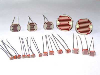

There are a wide variety of the CdS photoresistors and the manufacturing tolerances vary wildly. The one that I used had a range of 3KΩ when well lit to 30KΩ when dark. Depending on the photoresistor that you use, you may need to change the value of the resistor between pins 2 and 4 (the 10KΩ resistor). In order to activate the timer, this resistor must have a resistance at least two times larger than the photoresistor when it is illuminated. Adjusting the value of this resistor will also change how sensitive the sensor is. I recommend trying out several values before soldering the circuit together.

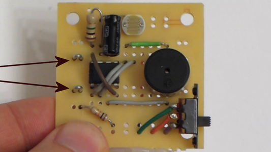

Step 4: Battery Holder
To make the battery holder, cut off two pieces of the paper clip that are about an inch long. Fold each of them in half. The bent end is where they will contact with the battery. The cut ends will be soldered to the board. When positioning the battery connectors on the circuit board, choose pin holes that are spaced slightly further apart than the length of the battery pack. When soldering them, try to align the connectors so that they are leaning slightly towards each other. You want the tips of the connector to be slightly narrower than the battery so that it will make a tight fit with the battery pack. It is important to get the connectors close to their final position before soldering. You can bend them a little after soldering but putting too much pressure on the solder joint can break it.

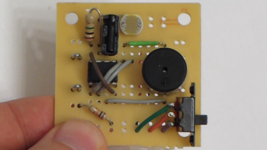

From here on, it is a pretty straight forward soldering job. If you are using the same PCB, you can just copy my layout. Try to keep all the components as low to the board as possible. This will make it a lot easier to make a cover for the circuit later. Once everything is soldered, attach the battery and test out the circuit to make sure it is working properly.
Note: In my first version of this circuit, I just removed the battery to turn it off, but that got a little annoying. So I went back and added the power switch (retroactive engineering!) To do that, I had to sever one of the lines between the battery terminal and the rest of the circuit and solder in the switch in between the two points. If you want to include the switch from the beginning, I recommend moving the IC down a few holes to make room.
