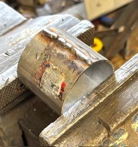

Step 2: Shape, Weld, and Grind the Collar
Place the piece of exhaust pipe into a vise and gently begin to squeeze it to close the opening. Do this in steps and try to preserve the roundness of the piece without it becoming an oval. Lightly grind away as much of the coating on the metal at the seam as possible and weld the seam. Grind the welded seam smooth. Squeeze the welded collar in the vise to remove any signs of an oval as much as possible.
