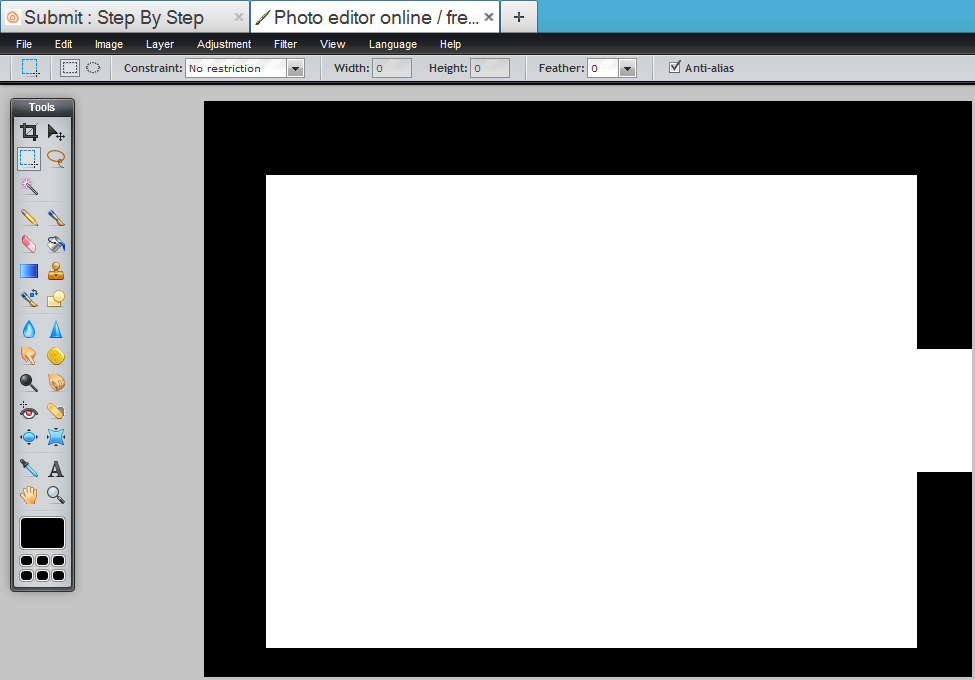

If you have photo editing software go ahead and use it otherwise head over to Pixlr.com and use there free online photo editing.
Make a new photo with a size of 1024x768 pixels. Zoom in to 75% or so that the flask fits in it. Place the flask on the computer screen and trace around it filling everything that the flask dosn't cover.
Draw the picture you want to engrave in the white area, only draw it with one color because engraving can't add different colors.
thinner lines are better. a shape with the outline done looks good. Coloring in a solid shape ends up looking funny under different lighting.
