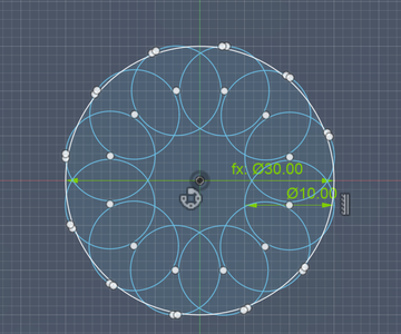

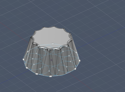

I parameterized the size and height to make sure that it followed the size requirements of the project. With the height being 30mm and the diameter being 30mm. The result wasn't what I expected looking more like a reeces butter cup but still a nice shape. I filetted the top in order for the piece to more easily be removed from the mold. I kept in mind the entire time that I had to have a draft angle. I made a larger circle for all the smaller circles to fit into. I made one small circle and made the end more sharp by using a line. Using the circular pattern tool I made 12 circles around the center axis. From there I extruded it with a 15 degree draft angle. I then imported the object as a component to the mold file to make sure that it fit.
