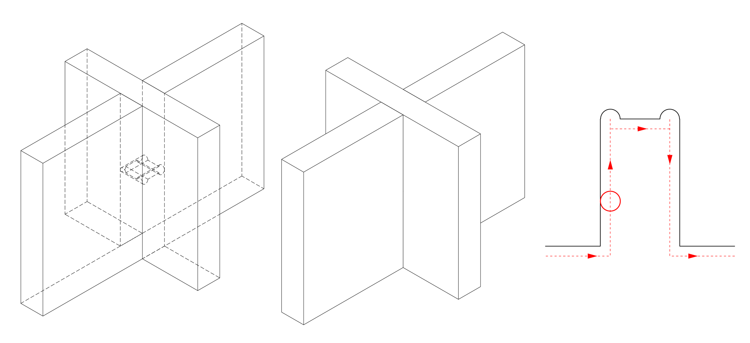

FLAT PACK / FRICTION FIT
This table is designed to be flat packed and friction fit. Flat pack refers to its being made of interlocking flat parts, and friction fit means it can be assembled so that the friction between the pieces will hold it together without any fasteners.
The table has 7 parts in total. Two legs, four stiffeners, and one table top. The stiffeners provide lateral stability to keep the table from twisting or wobbling.

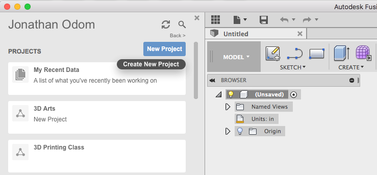

UPLOAD THE MODEL
1. Download the F3D file attached here.
2. Open Fusion, open the Data Panel by clicking the Grid icon on the upper left.
3. Click the New Project button and create a project with a unique name.
4. Click the Upload button at the top of the Data Panel.
5. Drag the table file you previously downloaded into the window and click Upload. The table design will now be in the cloud along with all your other Fusion files.

INSIDE VS. OUTSIDE CORNERS
Corners have one simple rule in CNC: Outside corners can be sharp, inside corners must be rounded. Since a round end mill is doing the cutting, the radius of any inside corner will always match the radius of the end mill. Sharp outside corners are easy, but there's no way to get sharp inside corners with an end mill on a 3-Axis CNC.
Because of this universal fact, you cannot leave rectangular geometry as-is after designing a flat pack object and fit the parts together as desired.
Of course, you could always chisel out the corners or use a file, but if you want to quickly and cleanly assemble the project, there are a few tricks listed below.
OUTSIDE FILLETS
This corner treatment allows for a flush connection between the parts because the end mill travels outside the corner by a distance that's equal to the radius of the bit, allowing the end of each cut to sit flush against the other. This kind of joint works well structurally speaking, but the fillet is visible after the parts are assembled.
INSIDE FILLETS
This corner treatment allows for a flush connection between the parts because the end mill travels outside the corner by a distance that's equal to the radius of the bit, allowing the end of each cut to sit flush against the other. The difference is that the fillet is cut into the short end of the cut. This kind of joint works well structurally speaking and is invisible once the parts are assembled.
Inside fillets can be a bad idea if the material is too thin as compared to the end mill. For example, if you were to use a 5/16" end mill with a 3/4" piece of plywood, this type of fillet would leave you with a 1/8" flat spot on the inside of the corner, which would probably just get broken off with soft plywood.
DOGBONE FILLETS
This corner treatment allows for a flush connection between the parts because the end mill travels outside the corner at an angle so that the cut is made equally on each leg of the cutout. Let material is cut with this method, it can be done automatically using a script, and the fillet is less conspicuous than an outside fillet would be. I pretty much exclusively use inside fillets because they're invisible, but doing doggone fillets with a script is definitely a time saver.
