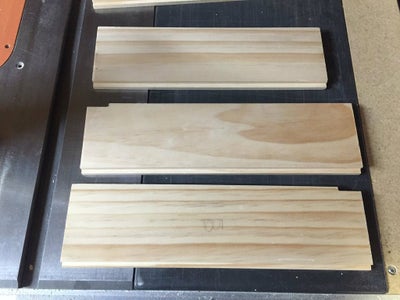

Step 4: Building the Lower Half (Part 1)
Start by cutting the the 3 boards that make up the frame (1001, 1002, and 1003). As stated previously all the drawings are available for download. I personally cut these pieces using a table saw, router, and hand tools like chisels and rasps to get the small cutouts. You could use a CNC router if you have one.
How you attach the 1001 and 1003 side panels to the front 1002 panel is up to you but I chose to use pocket holes with a Kreg jig. After attaching the 3 pieces together I lightly sanded to get everything level and square and then cut the 1010 base panel. I used luan plywood just because I had it. Shave the edges of the panel to fit snugly inside the grooves of the 1001, 1002, and 1003 frame assembly and fasten with wood glue and brad nails.
Fill the nail holes and gaps with wood filler and sand after it dries. If you want to stain the box, now is a good time to do this assembly.

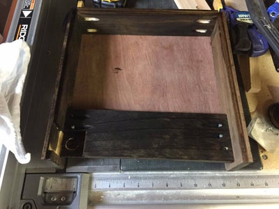

Step 5: Building the Lower Half (Part 2)
The next step is to add the support braces and the drawer slides for the Y axis. The bottom of the drawer slides needed to be approximately 3/4" off of the base and 1/2" away from the front panel. I used a couple of wood spacers on the left and right drawer slides to position them properly.
The 2 long 1019 support braces are attached to the 1010 base with wood glue. I used a number of heavy weights and paint cans to hold the braces flat against the base on top of a flat surface and waiting for it to dry. The intent of this is to keep the 1010 base form flexing in or out, which would cause the case to close improperly. Each brace should be at least 1.5" from the outside walls.
Now install the 2 hinges onto the lower assembly uprights. Half of the hing is on the uprights and the other half is on the inside edge of the lower assembly.
Sorry about the level of dust in the pictures. After staining the surface is still a little oily for awhile and attracts EVERYTHING. In the end I'll be cleaning the entire assembly and putting on a coat of urethane to protect it.

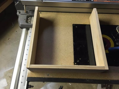

Step 6: Assembling the Upper Half (Part 1)
The upper gantry is assembled similar to the lower half. The 1004 left gantry panel and the 1005 right gantry panel are attached to the 1006 top gantry panel with pocket hole screws. Before tightening completely, install the 1010 gantry panel and the 2 X-axis rods into their respective positions. Make sure the LM6LUU linear bearings are on the shafts before you assemble them.
The next step is to install the 1007 rear gantry support, but before you do that it's much easier if you install the stepper motor, idler, and belt onto this board first. I did it after the face and it made it kind of a pain. I used an open ended strip of GT2 timing belt and 20 tooth GT2 pulleys. I wrapped the belt around the motor pulley and the idler pully and pulled tight while I clamped it with a pair of clamping pliers. I then used a belt clamp from OpenBuilds to secure the belt in position. If you have some patience, unlike me, you could build this assembly and then measure the distance around the 2 pulleys. You could then by a continues belt to the right length and use a belt tension spring. That's the "right" way to do this.

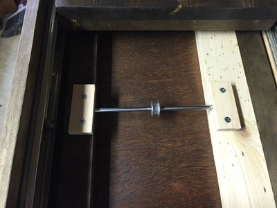

Step 9: Stepper Motors
X Axis
The X axis stepper motor, if not already done, can be screwed into the gantry rear support. While you install the stepper motor slide the 20 tooth pulley onto the shaft and tighten in place. Cut off a 1 inch piece of a 5mm shaft and slide it into the hole on the right end of the rear gantry support. As you pass it through put the 20 tooth idler pulley on the shaft and then push the shaft all of the way in. if the shaft is loose put a small dab of wood or super glue on it.
The belt will be trickier if done while the rear gantry support is already screwed into place. Wrap the belt around the idler and the motor pulley and pull snug. Use some sort of clamping pliers to hold the belt while you install a belt clamp.
Y Axis
The stepper motor mount for the Y axis stepper can be placed anywhere towards the middle of the machine towards the back end. Make sure that the game surface will slide the entire way out without making contact. Use wood glue and a couple of countersink screws from the bottom of the machine to secure it in place. The idler pulley for the Y axis is a little trickier. You'll need to use a 5 mm shaft to support the pulley and find a reasonable way to secure that shaft under the game surface. I glued an extra support brace on the base because I didn't have a long enough 5mm shaft to span the entire gap. I used a Dremel to cut a small notch on each end that the shaft could slip in to. I then cut a couple of covers that would go over the shaft to hold it in place. The belt for this axis is created the same way. Wrap the belt around both pulleys and clamp tight with a pair of pliers. Use another set of pliers to pinch on a belt clamp.

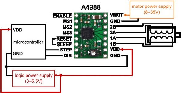

Stepper Motors
The stepper motors are drive by 2 Pololu A4988 stepper motor drivers. See the attached schematic for reference. The ENABLE pin is optional but I recommend that you use it. When the ENABLE is pulled HIGH the motor is shut off and doesn't draw any current. It also keeps the motors quiet while not in use. Another way to keep the motors quite is to use microstepping. If you leave MS1, MS2, and MS3 open the motor will take 200 steps to do one revolution. If you tie MS1, MS2, and MS3 together and pull it HIGH to 5V then the motor will do 1/16th microstepping. It will take the motor 3200 steps per revolution.
For the X axis the ENABLE should be tied to D9, STEP to D2, and DIR to D3. For the Y axis the ENABLE should go to D12, STEP to D4, and DIR to D5.
