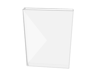

Step 1: Drawings/Designs
Sadly I could only get the pictures into PDF form but the last picture has tons if info.
Each one is a piece of the assembly, labeled with the proper dimensions needed for recreating or modifying. Depending on your 3d printer you might have to modify the dimensions as needed so that your printer is capable of printing to the desired resolution.

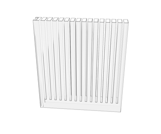

Short Side
The Short side is used for making fries or dicing. Each slot is .08 inches and the distance between each slot is 1/8th of an inch. So if you want you can make cubes that are 1/8in, 1/4in, 3/8in, etc. Or you can make fries 1/4x1/4x(any length) or larger and larger if you want. GO CRAZY!!!

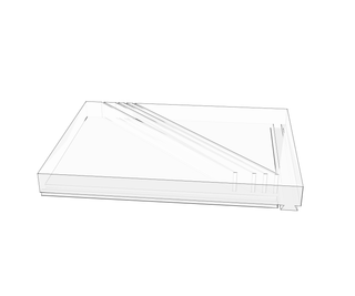

Long Side
The Long side is meant for slicing at an angle and is meant to be primarily thin slices that cover a larger area (hence why it is angled). If you just chop straight down into a potato that chips will be all different sizes, if you go at an angle the slices will be more similar and "chip-like". Like the short side, the slots are .08 inches wide and 1/8th inches apart (technically a bit more if you look horizontally instead of diagonally) The first slot is just the primary cut to "zero" the project so to speak. The second slot is 1/8th inch from the first to make 1/8th inch thick chips. The third slot is another 1/8th inch from the second slot and will cut 1/4th inch thick slices. The last slot will be a full 1/2 inch from the very first and will cut 1/2 inch slices... If you ever need them for some reason?
HOW TO USE
The three pieces all fit together so it is pretty straightforward. The short side and the long side fit together first, then the long side and the bottom. BUT!!!!! BUTTTTTT!!! Get this! you can slide the bottom piece along the long side so that you can cut larger produce!
