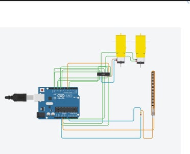

Step 1: Below I Have Attached the TinkerCAD Diagram
TinkerCAD diagram

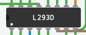

Step 2: Connections of Above Used L293D
Starting from top left :
  1. Power 1
  2. Input 4
  3. Output 4
  4. Ground
  5. Ground
  6. Output 3
  7. Input 3
  8. Enable 3&4
  9. Enable 1&2
  10. Input 1
  11. Output 1
  12. Ground
  13. Ground
  14. Output 2
  15. Input 2
  16. Power 2
