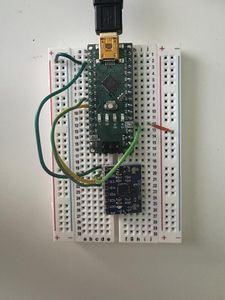

Circuit Components:

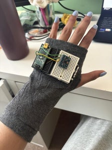

Because I didn't have access to a soldering iron, I made my circuit using a breadboard, but you can solder the components together instead of using a breadboard.
  1. ELEGOO 170 tie-point Breadboard
  2. The reason I used this breadboard was due to its small footprint and I could hide it better in the device
  3. Arduino Nano
  4. Pre-Soldered MPU-6050

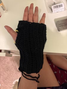

  1. Long Fingerless Glove
  2. I wanted to use a thin underlayer to build the circuitry on so I chose this device, but I ended up needing to modify the sleeve to be shorter.
  3. Crochet Cover
  4. I crocheted a modified arm warmer to cover the hardware components and I based it on this pattern by Ariel Tong, but I made some modifications

Step 1: Create Circuit
This part of the project is pretty simple, you just have to solder the wires together according to the circuit diagram. Like I mentioned earlier, unfortunately I didn't have access to a soldering iron so my circuit is built on a breadboard, but you could wire it differently.
  1. I used this video to help me wire the circuit

Step 3: Attaching the Breadboard

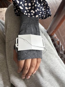

The next step of this project was making a spot for the breadboard to sit on the sleeve. I cadded a quick plate to sit on the back of the glove to provide a flat surface using Autodesk Inventor which is attached below. Thankfully, this solution gets hidden pretty well and provides a clean slate for the breadboard.
Next, you need to attach the plate by sewing it on using the guides on the sides. I ended up needing my sister as a hand model because this step is quite finicky. Make sure to pin down the plate first because it slides around the glove when you sew it on.
Finally, I just stuck the ELEGOO Breadboard on the back of the plate and the hardware was done!

  3. I also added a white shell stitch to the openings of the glove
  4. and finally I made a 10 by 7 double crochet rectangle to serve as the cover of the hardware components
Also at this step, you can hem the glove to your desired length if you want to which I ended up doing

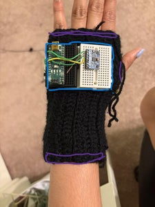

  1. Sew around the breadboard and try to keep the edge of the crochet cover as close to the plate as you can. I outlined this in the blue square in the photo
  2. Follow the purple lines and sew a running stitch around the outside to attach the liner to the crochet cover.

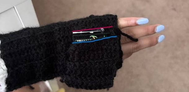

  3. Finally, you can add the cover to hide the hardware components. Use the photo above to sew the cover on the red and blue lines together.

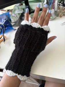

Optional step: I crocheted a shell border around the top and bottom of the glove just to make it prettier, but decorate it however you want to!
