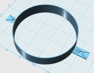

I was actually designing my part to be a fan shroud for an old fridge…Long story, but the printed didn’t end up fitting. It sure opened up a whole new path of 3D printing for me.
This is the hardest step because you have to create a thin enough object to only have two layers, but not so thick as to have any more. The only thing that will be bonding your layers will be the first layer, the one touching the print bed. This makes the print very flexible, but also very fragile. In the last step there are some photos of the cracks that have occurred from me playing with it. I am not exactly sure on the thickness of the walls, but It is somewhere between 0.25-0.75mm. Try out different thicknesses for different amounts of flexibility, and strength.

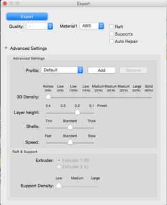

In the first photo is my settings, 0% fill, .20 layer height, standard shell, and standard speed. These settings worked for me on my Da Vinci 1.0, depending on your printer, you may need to adjust them a little bit.

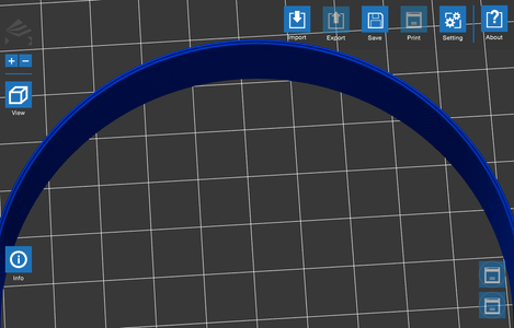

After you have sliced your model it should have two separate, defined layers. If you look in photo two, you can see the separate walls. My print was rather skinny, and tall, but I hope someone will figure out a way to make the sides of the object thicker. I think that if you modeled the walls into the 3d print, then when you printed it, they would not be connected, but there would still be the walls on the inside of a large print.
